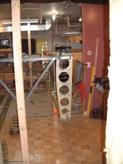

Brief Description:  Lifted left wing into jig...

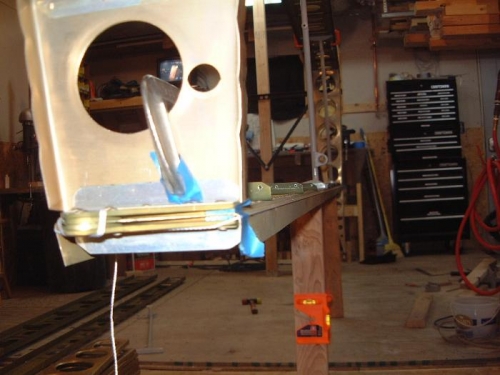

Today I began by doublechecking all of the clamps that are holding the left wing skeleton together. Then I lifted the assembly into the jig. After a little clamp manuevering, all was right except for the sag in the middle. This was solved by installing 2x4s to support the middle of the spar. A string was strung to check for straightness...good to go.

Left wing in jig
Left wing in jig
left wing level after 2x4 supports installed
