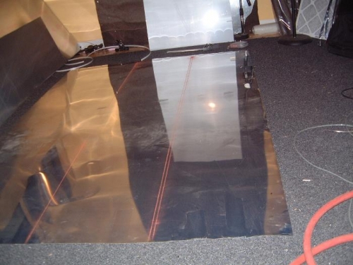

Today I continued to cut the remaining aluminum that needs to be bent on an 8' brake so that I can do it all in one trip.

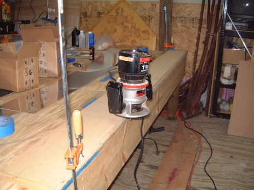

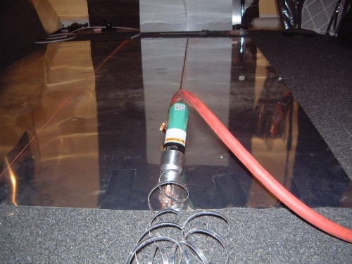

It begins by measuring and marking a piece of aluminum, then it is rough cut using a phuematic shears. Then the piece is moved to the bench and clamped down using a piece of MDF. Next, the edge is routed to create a straight line and finally the edges are deburred.
Marked Nose Skin
Marked Nose Skin
Rough Cut Nose Skin
Rough Cut Nose Skin
Final Cut Nose Skin
Final Cut Nose Skin
