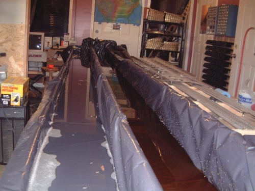

Began alodining spars.
Today I built two 16 foot troughs out of wood and plastic to hold the alumiprep 33 and the alodine 1201. This was long enough to hold the rear spar cap strips which are 167" long. Then I alodined all of the spar webs and spar cap strips.
Alumiprep and Alodine
