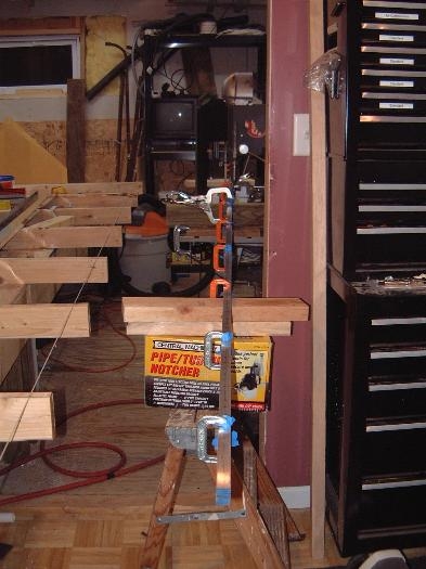

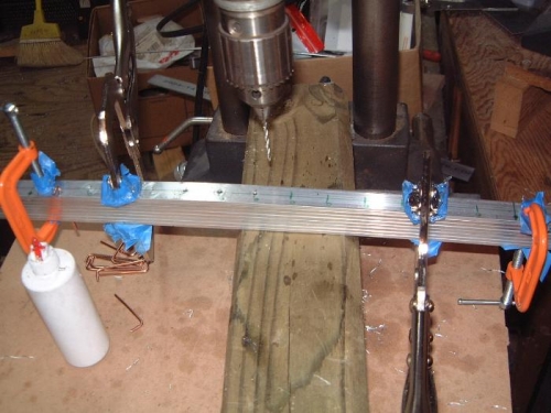

Brief Description:  Began match drilling the rear spar cap strips.
Tonight I began match drilling the rear spar cap strips. I have them all aligned and clamped together. Then I was trying to figure out how to keep the holes aligned after they have been drilled. I couldn't find any bolts or screws that were skinny enough and long enough. Then I thought, "Hey! I have 3/32" welding rod!" In the second picture, you can see the rod cut and bent on one end to stop it from going all the way through the hole. Works great.
Match drilling the rear spar cap strips
