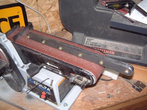

Brief Description:  Finished cutting and match drilling strut attach b
Tonight I finished rough cutting the strut attach bars. I then clamped them together and match drilled the 1/4" holes. Then I bolted them together and began to final shaping on a belt sander.
Final shaping strut attach bars.
