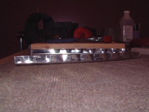

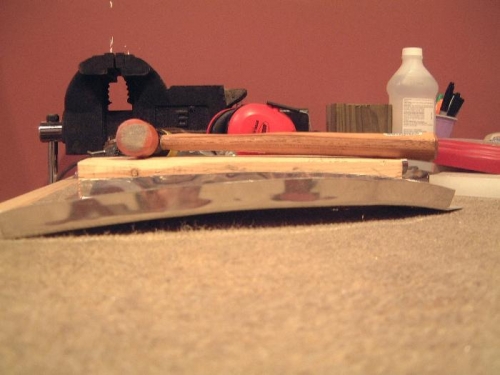

Ribs are formed by placing the rib between the form block and a backer plate. Then the flange is pounded over. Next it is placed upside down on the bench and the flanges are pounded to 90 degrees. This leaves the rib bent because of the extra material
Flange at 90deg. but unfluted
Fluted rib
Fluted rib
