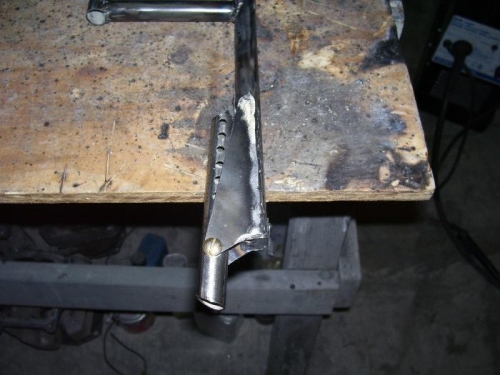

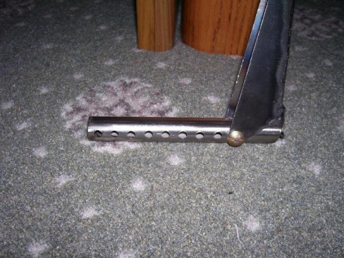

Brief Description:  More Rudder Pedal Work
The retractable pedals on the passenger side now have stainless steel pieces instead of the original steel parts. They were cut from 3/4" stainless steel with a angle grinder. Next they were drilled initially on a miniature milline machine. The holes were then enlarged on a drill press to .25". I finished one of the pedals completely with a general polish job. It is not polished to a finish for a "show", but rather to a nice appearance. The other pedal still has to be done in the same manner. The second pedal set got the remaiunder of the retractable pedal assembly installed and adjusted.
