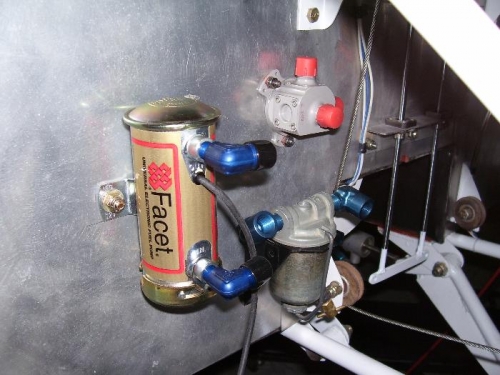

Date:  2-19-2007
Number of Hours:  2.50
Brief Description:  Adding Low Pressure Items
The plane, as currently being constructed, will include both a low pressure and high pressure fuel system. Right now I am adding the low pressure side. The parts used are the same ones Siers suggests in the current construction manual for the most part. Today the Gascolator and the low pressure lectric boost pump were mounted. I have the plumbing figured out and am waiting for parts. Note: The gascolator is mounted to be used from the wheel well. Not the easiest spot to reach, but where Siers suggests and it will provide less drag on the plane.
