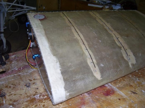

Brief Description:  Installing Tank Fitting and Sender
I added the fittings, sender, vent line, filler cap and pickup tube to the tank. First each hole is drilled. Next each assembly is made up. Third they are test assembled in place. Forth disassmbled from the tank. Fifth they get reassembled with fiberglass resin to seal them. Thw right tank has zero leaks, so I am just doing the exact same process with the left tank.
Assmbled End Tank Fittings
Left Tank End View
Left Tank End View
Filler Cap in Upper Left Corner
