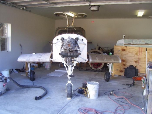

Date:  11-19-2006
Number of Hours:  5.00
Brief Description:  Left Tank Work
I transferred the wcp to the outer end of the tank. The tank was then test hung on the aircraft. I adjusted it as necessary and then attached it with 2 screws temporarily. My 14 year daughter held the tank while we set this up. Next I marked the locations for the 3 tank brackets. These were made previuosly from CAD files I did and sent to a service company via the internet. Production quality parts are always the result this way. The tank was then removed. I then disassembled the entire back of the tank. The holes for the bolts for the brackets were drilled and the brackets were bolted and "glued" in place with firbrglass resin. I also added the tank drain mount that was another CAD designed piece I had made some time ago. The small rear bracket that goes on the fuselage was also installed today.
Tank Temporarily Mounted to Left Side of Aircraft
View Of Left Side Tank Mounting
