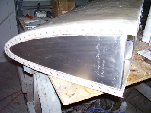

Brief Description:  Finnish Fuel Tank Ends
I finnished drilling and tapping the remaining 6-32 screws in the tank ends. I then dismounted the ends and "glued" them in place with fiberglass resin and reinstalled the screws. An additional coat of resin was added to the interior edges around the screws for final sealing.
Fuel Tank End
Fuel Tank End
