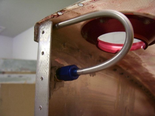

Brief Description:  Install Tank Vent
I added the tank vent using a bulkhead fitting. I felt this was better than just drilling a hole and glssing the vent tube in place as the plans state. The fitting was "glued" in place when it was scred together usinf the same fuel tank resin I have used to make this tank. It is vented to the location shown on the plans.
Right Tank Vent
Right Tank Vent
