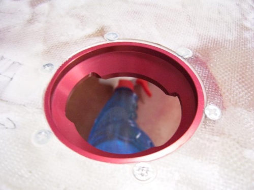

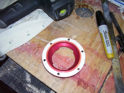

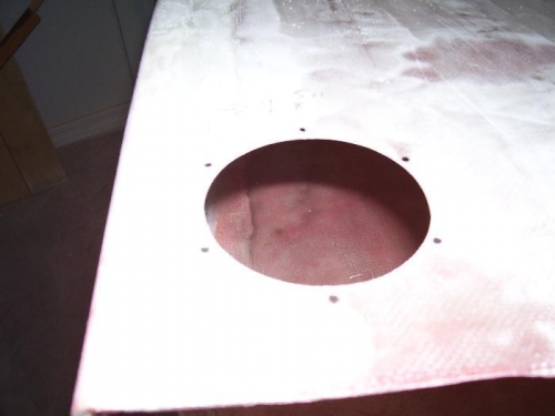

I first cut a hole 2.75" in diameter with a hole saw. I then slightly enlarged it by hand. I then made a laser-cut self adhesive pattern to layout the exact hole pattern on the tank and on the fuel filler. Each was marked with a "sharpie" and drilled. The fuel filler flange was tapped 6-32 for the mounting screws. A dry fit was done then the unit was liberally coated with resin and glued/screwed into place.
Fuel Filler Mount Hole and Screw Holes
Laser-cut Pattern on Fuel Filler Flange
Finnished Fuel Filler Mounted
