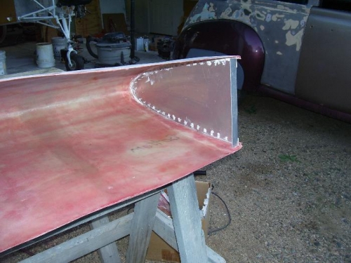

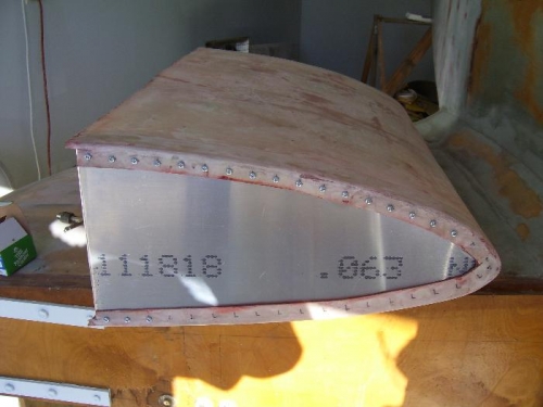

I cut out both tank ends for the right side tank. The smaller end was completely fabricated, drilled and tapped. It was then installed with lots of resin in the joint to seal it well. Resinh was also used on each screw.
Drilled and Tapped Tank End
Installed Tank End Inside
Outside Small Tank End Installed
