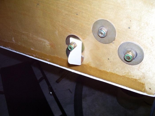

Brief Description:  Mount Inner Fuel Tank Brackets
I designed these brackets per the plans with CAD months ago. They were transmitted via the internet to a service firm. They were laser-cut, folded and powder coated prior to arrival. However, the tank mount holes were not cut allowing for an accurate mate to the actual tank brackets. These were installed on the lower front motor mount bolts per the plans with provision for a good ground connection.
Right Lower Tank Mount
