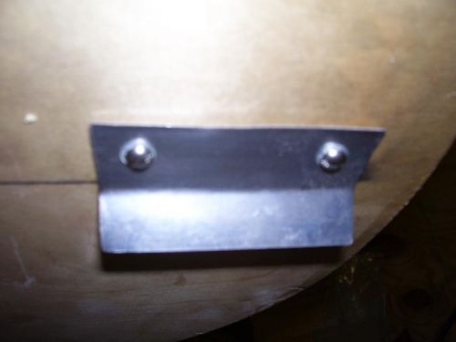

Brief Description:  Add Air Tabs
I added stainless steel tabs to the bottom of the secondary gear doors. These should be deflected on air in flight to force the gear doors against the stops when open. They are 1" in from the gear door edge and 3" long with a 3/4" angled tab to catch the wind. They are mounted into T nuts glued into the gear door with T-88 epoxy. The fasteners are also stainless steel.
Tab on Door on Work Bench
