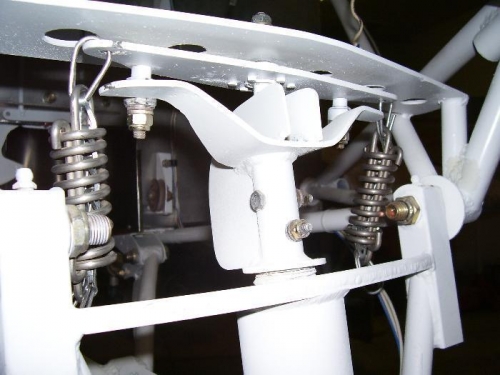

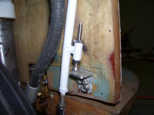

Brief Description:  Door Stops and Steering Springs
The door stops figured out yesterday were completed. They are made from 10-24 hex connectors, stainless screws, stainless jam nuts and aluminum angle stops. This stops any over motion of the doors and limits reverse motion in the open position. The steering springs were also figured out today and added per the plans. This entailed a modification of the inner chains to reverese a link to create a non-tangling chain.
