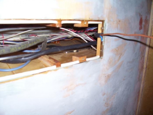

Brief Description:  Finish Left Landing Light
I fished the wires for the landing lights through the aircraft. Very time consuming at this point. I then completed wiring the left landing light circuit. Finally I cleaned up the wiring behind the panel in general some more. I try to do this every time I add something. Since I have been asked here are the parts used for this set up; Hella Xenon lights available from Wicks as part #8390801 and the best price at $599.00 I could find, you get one relay in the kit (2 necessary for seperate circuits) labled as a Hella part when it is a standard Bosch 5 pin relay available at any auto parts store for about $5.00, the switches came from Aircraft Spruce as part #14-307 for amber units and misc. wiring parts from the local hardware store. The brackets were made from thin wall 1" square steel tubing with 1/8" aluminum clamping straps for their tops. Final weigt of the custom brackets was 2.5 ounces per side.
View of the
View of the "Spinal Cord" of Wiring in this Aircraft
