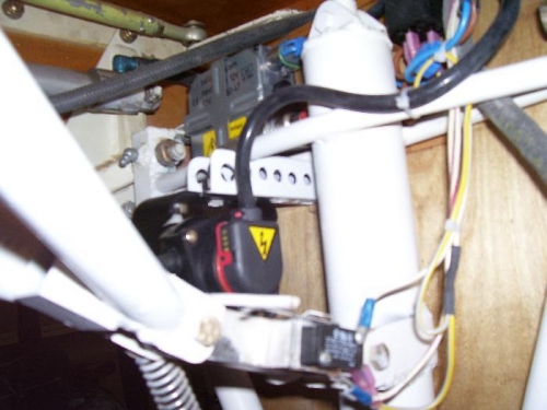

I have chosen to use Xenon lights installed on the main gear so they stow when not in use. Each light will have an independant circuit. Hence, the odds of landing with no lights will be greatly reduced. I spent the time today making the bracket assembly for the left side of the aircraft. I also added holes to the brackets to reduce their weight substantially. Finally, I mounted the completed brackets after painting. I also mounted the ballasts to the inside top of the main gear doors. Wiring the system remians.
Bracket for Landing Light
