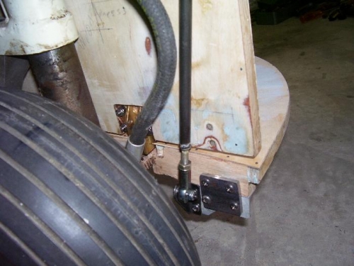

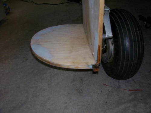

Brief Description:  Finishing More Door Modifications
I finished the right side hinge pin and plate. A also fixed a poor rivet on the bell crank on this side. The stop for the door on the pilot side was installed and finished. The hydraullic brake line fittings were changed out to match those on the right side, which gives more clearance when the door closes. The doors are structurally and mechanically complete. It does remain to be seen on high speed taxi tests if they move improperly at high speed.
Finished Door Assembly
Right Door Bell Crank
