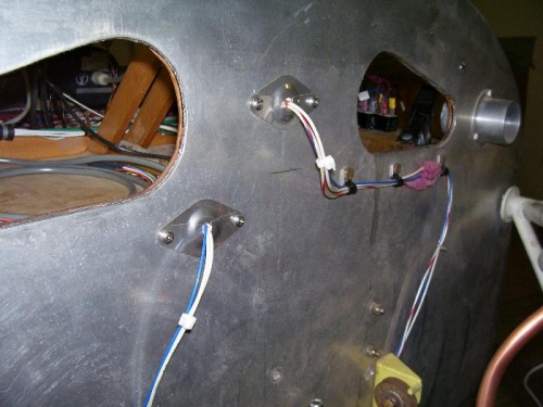

Final Installation of Nose Gear Wiring
I installed the stainless sheilds on the firewall after using copper filled rtv to seal the holes and fiberfrax washers in the sheilds.
Final Nose Gear Wiring
