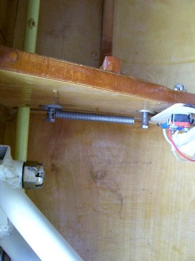

Brief Description:  Change Uplock Hook Spring
I chnaged the gear uplock hook return spring on the right seat side of the aircraft. The old springs are just too strong. It was necessary to weld a new bolt and washer combination mount to replace the old mount for the larger spring. The new spring reduces the force needed to move the landing gear activation lever and makes the hook move into the proper postion better. I will change the pilot side in the same manner soon.
New Uplock Hook Return Spring
