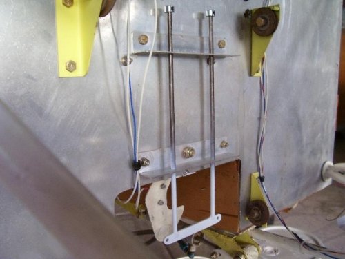

Brief Description:  Finish Nose Gear Door Carriage
I removed the carriage assembly for the nose gear doors. IT was cleaned up and the lower portion finish painted white. The 2 rods will slide up and down in the angle supporst so painting them is not necessary. I then put the unit back in place and installed stop collars on each of the 1/4" rods. These will be adjusted later for correct position.
