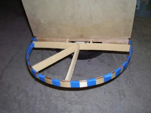

Brief Description:  Added Layers of Plywood to Door Outer Ring
The right seat landing gear was placed back on the gound. This shows the location of how the door actually opens. The foam formers holding the shape of the door are easily seen. The outer edge now has multiple layers of aircraft grade plywood epoxied onto it with T-88 Epoxy. The tape is there to hold it together over night. It will then be removed.
Building up Outer Door Edge
