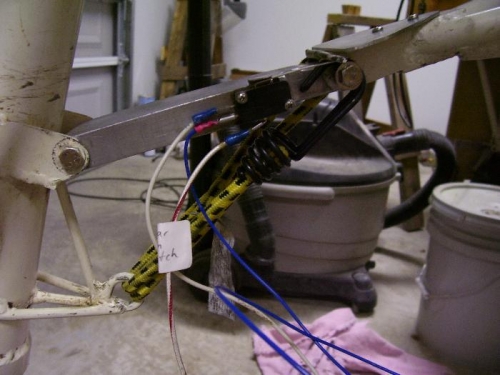

Brief Description:  Front Landing Gear Work
I modified the over center link to allow travel per the instructions of .125" over center. This works without weight. However, I have yet to get enoungh tension from a temporary bungee or spring to hold this over center when the aircraft rests on the nose gear. Siers claims a 3/8" bungee was used. I am not happy with this installation yet.
General Over Center View
Close up Over Center View
Plan View Over Center
