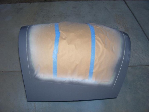

Brief Description:  Right Canopy Door Work
I started in on wet sanding the right canopy door. All the wood parts on the aircraft have been completely coated with T-88 epoxy thinned with MEK in the past, so water does not absorb into them. However, very little water is used when I wet sand these parts just in case.
Just Starting to Sand
