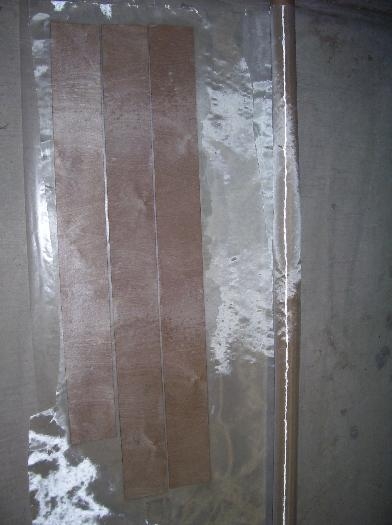

Brief Description:  Start Flap Gap Seals
I am adding flap gap seals made from 1/64" plywood glassed on each side. These are not items on the plans, but an addition. THe plyood parts were cut and an initial coat of fiber glass on one side was applied. Thinned T-88 epoxy was used to adhere the fiber glass.
Seals Partially Completed
