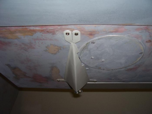

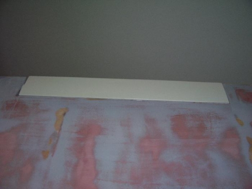

I finished up the paint job on the trom tab with some light sanding and the application of clear coat. I also installed brass thread inserts in the tab and the elevator for the trim tab hinge. This allows me to use stainless steel machine screws instead of wood screws in this area. The fairing for the trim actuator rod was also painted and installed.
Trim Tab
Trim Tab
Trim Tab Actuator Rod Fairing
