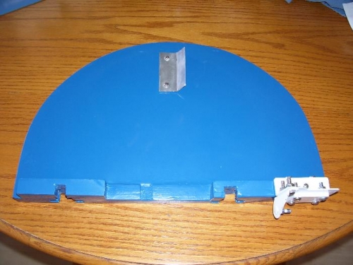

I worked on finishing 1 of 4 gear doors. This is more of a learning curve at the moment since I am using Loele paints and have not used them befor. I sanded the primer and then finished up any additional flaws I found. The color coat in this case is Loele Replica Blue. So far, regardless of what I have done I keep finding what appears to be paint contamination. Having painted many cars with only one similar time with such a problem I remain at a loss as to exact cause. I have replaced all filters in the air system, cleaned the parst with several different methods and experimented with different application methods. I may try an anti fish eye additive. A solution will be found. These problems resulted in color sanding for the color coat and the clear top coat. I could do that every time, but the work load is unacceptable.
Completed Underside of Left Gear Door
