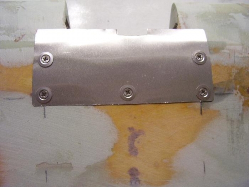

Brief Description:  Change Fasteners on Aileron Hinge Covers
I started changing out the fasteners for the aileron hinge covers. Some of the covers were also remade as necessary. The covers are aluminum. THe washers are stainless steel Tinnerman counter sunk washers and the screws are stainless steel 100 degree head screws. This make for a nearly flush attachment system.
Sample Cover Assembly
