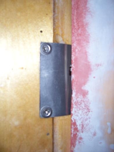

Change Screws Out on Flap Hinges
I counter sunk the screw holes and installed Tinnerman washers and 100 degree head screws in stainless to make the mount points as aerodynamic as possible.
New Nearly Flush Fastening
