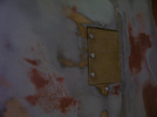

Brief Description:  Modify Upper Hinge Doors.
I added 1/2" square pads to the backs of the mounting tabs on these doors, New countersuck holes were added to the vertical stabilizer skin just above and below these doors to allow for screws that mount into the door tabs. This improves the fit in the area and makes the doors more secure.
Modified Hinge Rudder Hinge Doors
