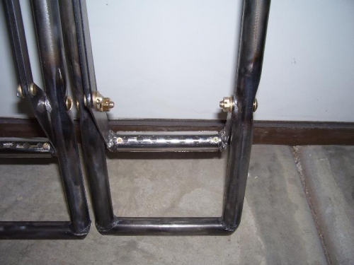

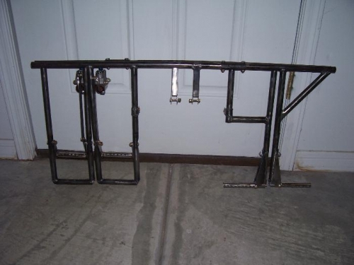

The second retractable pedal was polished and installed. The steering bracket was added, the master clinder bracket was added, the brake pedal pivot points were added and the master cylinder actuating lever was modified. The clamp joint was aslso completed for this pedal assembly. I also made the brake pedal pads out of stainless steel. They are made from 3/4" stainless steel drilled more for effect than anything. I mounted them with 4-40 brass screws. They have been added as they will not rust or need paint ever. They were also polished a bit prior to adding them in place. I have 7/8" stainless steel tube on order to make lower pedal pads to complete this assembly. It is done in all other respects and ready to see if it fits in the aircraft.
Completed Assemblies Minus Bottom Pedal Pads on Left Seat Side

Stainless Pedal Pad
Stainless Pedal Pad
