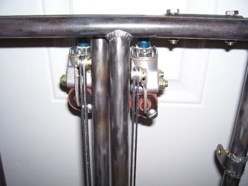

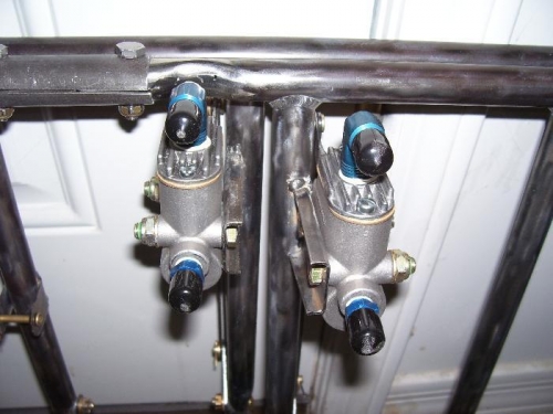

I wire brushed 2/3" of the second pedal assembly to remove all of the paint from it. The fittings were installed in the remote Grove 06-00819 master cylinder reservoir, master cylinders (given in a previous log) and 06-17200 Matco parkiing brake valve I am using for the assembly. A mock up of the two rudder pedal assemblies showed a slight additional need for modification in the recess I put in the second assembly upper tube. This recess is to clear the #4 size fitting which will connect via an Aeroquip hose to the Grove reservoir when completed.
Note Recess Above Left Master Cylinder
Front View or Pilot Side View
