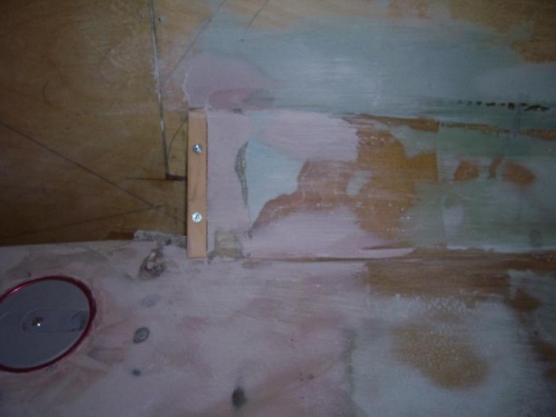

Brief Description:  Finish End of Fairing
I added a skim coat of body filler and when cured sanded same. The wooden forms wre left in place when adding the filler and removed for the sanding. It took 2 light coats with sanding between each coat to get a good finish. These areas are currently sanded to a rough surface with 80 grit Hookit2 by 3M.
Fill Coat Fairing End
Filler Sanded on Fairing End
