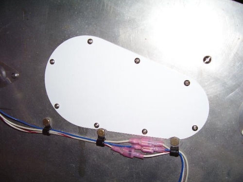

Left Firewall Access Panel
This access panel installation was the same as the other save needing to modify the pael with two half round cut outs at the bottom to clear bolts mounted there years ago. I also added a layer of fiberfrax to the rear of each of these access panels.
