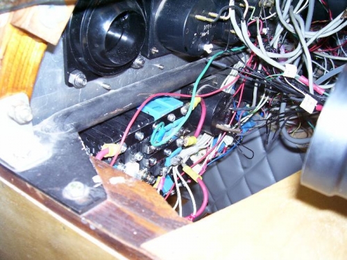

Brief Description:  Wiring Many Systems to New Circuit Breaker Panels
I wired bus bars to all the circuit breakers. Everything is on the same bus except the deice system and the avionics system. The avionics system is wired to its own master switch and hence its own bus. The deice system will draw too much current to not be seperate. I also wired the ground side of the stall horn. The master switch line was lengthened and attached to the main bus. I also had to lengthen the hydraullic pump wire when attaching it to its new circuit breaker. The circuit breaker used for it is different than all of the others in that it can be pulled out by hand if necessary in the event of a run away pump. The gear lights, supercharger master, clock, turn coordinator, map light, instrument lights, strobe system, navigation lights and fan were also wired as much as possible at this point. I also ran the ground connections for the Heat Panel switches.
Rear of Upper Circuit Breaker Panel
