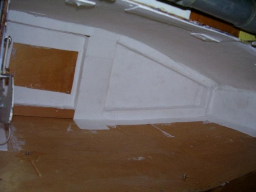

Date:  8-3-2006
Number of Hours:  4.00
Brief Description:  Installing Fiberfrax
I added Fiberfrax to half the gear well. This is very hard to do as one has to work above their head and I do not fit the space well. It is rather like building a cast. I have over lapped all the pieces at least .5" to make the installation as fire proof as possible. After all it is a wooden aircraft.
Fiberfrax Installation
