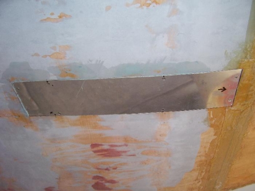

Brief Description:  Finish Lower Fuselage Access Panel
I added a bit more filler around the edge of the panel as nessesary. When it was cured I removed the door and finished sanded the area around the door. I then used T-88 Epoxt thinned with MEK to seal all of the wood work in this area. I also used the T-88 to fasten in one of the screw mounts as it was loose. Lastly I waxed the back of the door and put it inplace to allow everything to cure in place.
Finnished Lower Fuselage Door
