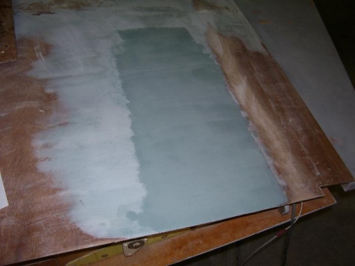

Brief Description:  Repair Mounting Holes and Fill Wing
There are 4 mounting holes that were either in the wrong place or slightly loose fit in the right side wheel well. These were repaired with 1/4" birch dowel and T-88 Epoxy. There were tight press fit with the glue and will be stronger than the original material.The pilot side wing was sanded again and aniother light filler round performed again. The total thickness is less than 1/16" at any point even with multiple layers. This should be the last layer.
Pilot Wing Filling
