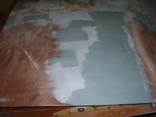

Number of Hours:  0.80
Brief Description:  Wing Surface Filling
I added the third coat of filler to blend the potion of the wing you can walk on and a slight depression in the surface with the rest of the wing. I find 3 coats minimum are virtually always needed to do a good job. Sanding has been done between each coat, of course.
