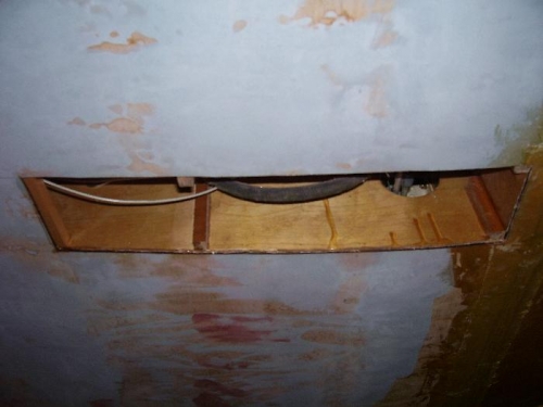

Brief Description:  Begin Adding a Bottom Console Access Panel
Siers has added a suggested change to the aircraft. He suggests adding a bottom console access panel. I would say this is not a suggestion, but manditory if the aircraft is to be possible to service correctly.I laid out a 4" wide access that is 17.5 inches long using the spar locations as the ends of the access panel. This was done with careful measuring and the use of a pencil to mark the aircraft skin. Once I was satisfied with the layout I used a Dremel tool with a Forney cut off disk to carefully cut along the laid out lines. The real trick here is to just cut through the aircraft skin. A chisel and hammer were used to get the section out in pieces. I have yet to do all the final clean up of the opening. However, I hit the correct location nearly perfect. The last thing done with this area today was to add a spruce reinfocement piece to the rear of this new opening. Several more pieces will have to be added to allow the attachment of the access panel.
New Access in Bottom Center of Fuselage
