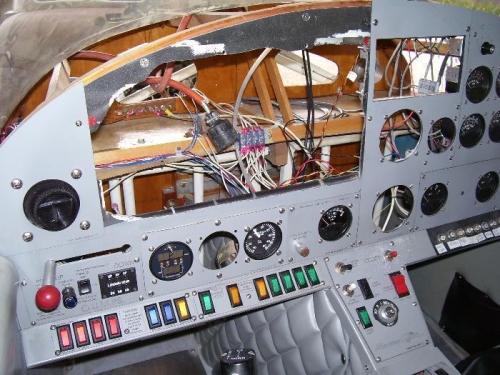

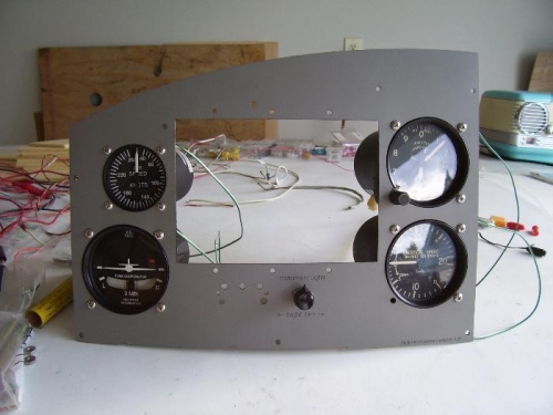

Brief Description:  Finish Instrument Sub-panels
I installed the electric turn coordinator, 2.25" airspeed indicator, altermeter and vertical speed indicator into the laser-cut assembly I had made up for this panel. Also installed at this time is the rheostat for dimming the panel lights. The main rectangular hole is for a Dunon Avionics glass panel instrument to be added later. The holes under this cut out that are not filled are for the intercom unit to mount to.The second piture shows the hole cut in the 1/8" aluminum instrument panel to receive the flight instrument panel.The third picture shows the right hand side of the instrument panel at this state. I temporarily added all the stainless screws to the avionics panel.
