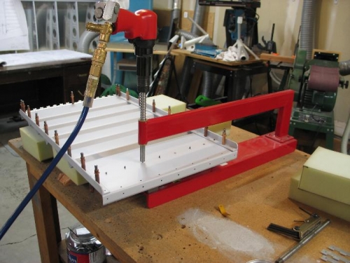

Riveting seat backrests this morning. Started with the upper hinge. I used the C-Frame to pound the rivets. I like this better then gun and bucking bar. I put hockey chin tape on all the factory heads.
I started to squeeze the vertical angles but I saw a tendency for the rivets to tilt so I went back and used the C-Frame of the whole darn thing.
