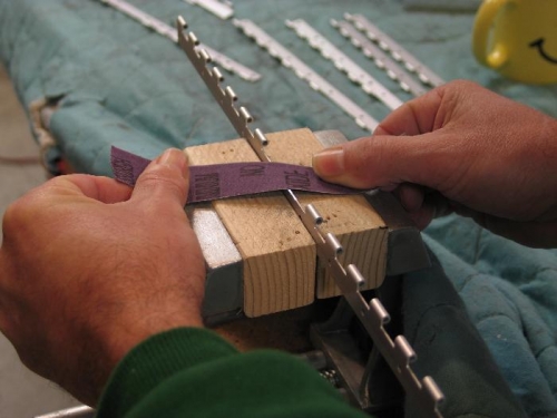

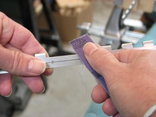

Brief Description:  Remove un-needed piano himge eyes.
Goal here is to remove 2 hinge eyes on the 6 hinges that are on the floor and make it look as if the hinge was manufactured that way. I mean leave it such that no evidence is left that a hinge eye existed.
Cut off the 2 eyes with the band saw, sand drum smooth and emery cloth to finish it off.
Sand drum smooth.
Sand drum smooth.
FInish off with emery cloth.
