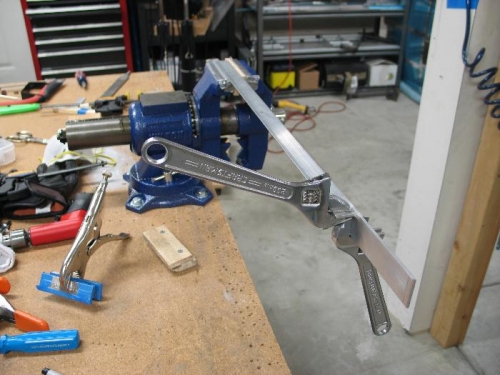

Brief Description:  Fabricate F-717 Lower Longeron.
This was slow but easy work.
Find the stock,
Cut in two,
Cut off aft flange and angle remaining flange,
Cut the final length, trial and error. Mine are 1/32” shorter then the plans dimension of 26 5/8”. Must be that my firewall is 1/32” aft of where it should be. Detail A on drawing 23 shows 5/8” between the forward edge of F-772 bottom skin and AFT side of firewall. Well, this does not make sense because earlier on, the plans say 5/8” between the forward edge of the F-720 side skin and FORWARD side of firewall. The F-772 and F-720 are flush so how can this be. I think this explains why my holes on the firewall top angle are 0.02” (thickness of firewall) off of the center line. Oh well.
Twist it.
Cut it.
Cut it.
Shape it.
Shape it.
Twist it.
Twist it.
