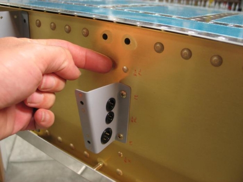

Brief Description:  Fit gear mount, Add edge notch.
Image 1 and 2 shows a notch that was missing from only one of my mounts. Weird.
Image 3 shows a universal rivet I installed even though the plans said to make it flush. At the time I didn’t see why it needed to be flush so I didn’t. Well, now I know. Part of the gear mount needs to fit flush here. I drilled it out.
Holes expanded in one direction.
Added this edge notch.
This rivet needs to be flush.
