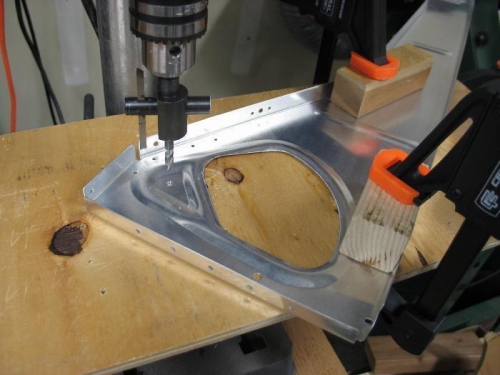

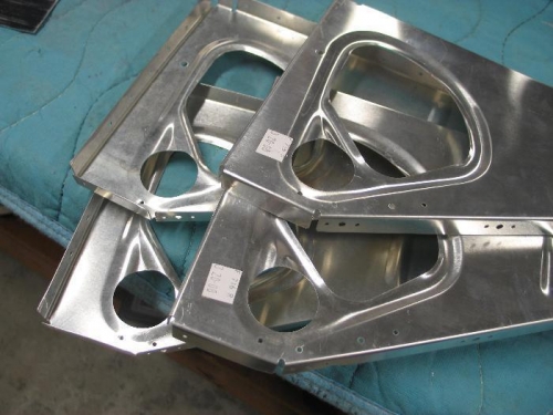

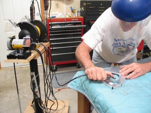

4 of the F-716 floor ribs need to have the lightening holes enlarged. I used the fly cutter to cut the 1 ½” diameter hole. Worked nice. Then used the mini cutoff wheel in the Dremal to cut straight from the existing lightening hole to the new hole.
Fly Cut 1 1/2" hole.
Cut out with Dremal cut off wheel.
