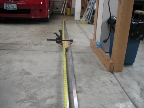

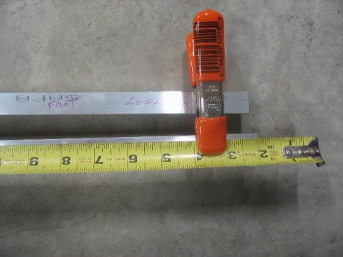

Need to cut the longerons to 173 7/16". Measured on the floor. I clamped the tape at the 2" mark to avoid any error in the lip at the end.

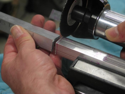

While I was at it I put the other marks on them. Then used a cut off wheel in the die grinder and made a rough cut 1/16" from mark.
Clamp at 2
Clamp at 2" mark.

Cut 1/16 from mark.
Cut 1/16 from mark.
