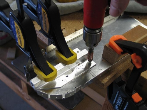

Brief Description:  F-712 BH - Match drill 712E to bulkhead.
The vertical placement is called out in the plans. I little confusing though. The dimension line is obscured behind bolt thread lines and it's not obvious what the dimension line is lined up with. A close look and it becomes clear.

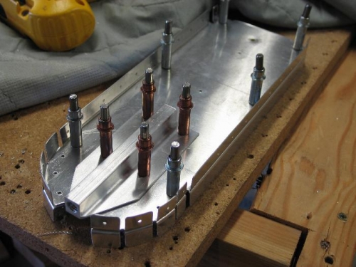

No match drilling here. You have to mark it up as per plans. Clamp and drill. I didn't drill the holes that are left open for Vert. Stab Attachment. 2 of these holes need precise positioning to bolt to the vert. stab hinge. I have to think about this a bit.
Mark, clamp and drill.
